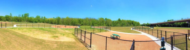

So the fenced in dog parks are A's???
The fenced in playgrounds at elementary schools
The fenced in ...................................

CDA to answer your question: IMHO every structure must have a classification. A dog park would be a U. The fenced school playground is murkier, probably an E, since it is a space, and is an assembly space associated with an E occupancy. (I have never been involved with a school playground so I am interested in the strategy of others who have.) Assigning an occupant load to either space is up to the CBO. The panic hardware to get out of the pool area would be within the 34" to 48".
