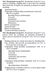

Good morning, has anyone had any experience with occupancy classifications for church buildings, specifically for parsonage or rectory or a space within a church thats used for permanent living quarters? Would it be categorized as an R-3 occupancy?
