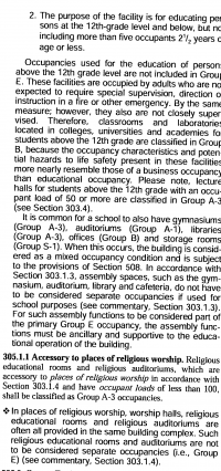

Check the wording in your adopted code::;
305.1.1 Accessory to Places of Religious Worship
Religious educational rooms and religious auditoriums, which are accessory to places of religious worship in accordance with Section 303.1.4 and have occupant loads of less than 100 per room or space, shall be classified as Group A-3 occupancies.
I wouldn't call a separate building being rented out accessory.....

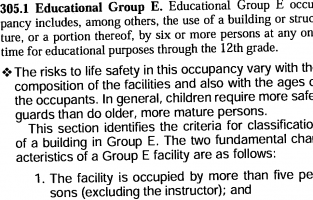

During the time it is occupied, this adapted school building will have the same risk to life safety as a school. 380 students through 12th grade and their adult supervisors, distributed around the building in classrooms. It will certainly look like a Group E occupancy.

We only know one use for sure, and the code doesn’t address duration. If this was an arena, we would design it around the occasional event, not the rest of the time when it is empty.
I would say "E" for now and when they want to rent a room for a meeting since they cannot have over 50 occupants in a room it would not be "A" it would be a "B". I think "E" is stricter then "B" except "B" needs more plumbing fixtures.
For what it's worth, my understanding of the origins and intent to not call a religious use an "E" occupancy, goes back to the original intention of "Sunday School", where the parents we in a church service in the sanctuary, while the kids were in "sunday school class" in other rooms on the same campus.
If there was a fire or other emergency, the parents could go to the classrooms to help evacuate their kids.
In contrast, a regular state-mandated K-12 education puts a classroom full of kids under the sole life-safety responsibility of one adult teacher. With that in mind, the life-safety issues of an "E" school use are different than an "A3" Sunday School occupancy.
None of this is stated in the code - - it's just anecdotes I've heard over the years as to how the code came about.
