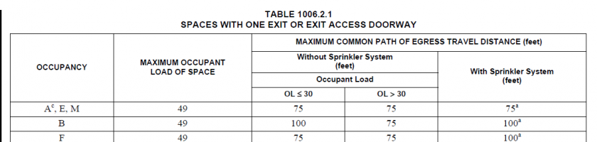

So, will give as much detail as possible, if missing something let me know
This is not my area, just trying to get educated on this one exit thing
2015 IBC
two story type V building/ not built yet
One tenant for entire building
B Occupancy
Fire sprinkler system
5800 Sq Ft per floor
100 x 58
55 occupant load per floor
One open stair, only for exiting from the second floor
the one open stair dumps into the first floor corridor, and not directly to the outside.
So questions I see so far.
Code sections would be highly appreciated.
1. Does the second floor require two exits
2. 2nd Floor worse case travel, just to get to the stair, and not down to the first floor, is 225 feet.
3. Can they have an open stair
4. Can the stair dump into the building, and not directly to the outside
5. if possible, and the occupant load can be lowered, will that help with the above questions?
Thanks trying to learn, just a few extra parts in this one.
You exceed 1,000 sq. ft and/or 10 occupants: 2 accessible means of exit from 2nd floor required
There is an elevator
I did not throw that in, because I did not think it counted ???
Right wrong??
table 1006.3.1 required two exits from from a story with an occupant load of 500 people or less. 1006.3.2 list situations where a single exits from a story is allowed but none of the listed conditions seem to apply to what you have described.

this section is for enclosed interior exit stairways, and open stair would be an exit access stairway, different section in the code.
Reduce building size with the occupancy <50 on each floor or since you have sprinklers add 2nd exit on the 1st floor and design for CPET to comply with exit access stair location.
