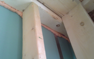

I came across this situation in a school where FMC conduit was penetrating a fire rated wall separating a classroom from the corridor.
whenever I see orange foam on a commercial job site I sort of cringe and start hunting for it. I read the ICC – ES report for this and it is basically for blocking in wood frame construction on residential structures.
what are your thoughts?

Yep not good for rated wall penetrations.
I like to take a hunk of it, use a lighter and show them how good it burns.

From the description of the wall (a fire rated wall separating a classroom from the corridor), by the IBC it would be considered a Fire Partition (Section 708), and Section 708.7 requires penetrations of Fire Partitions to comply with Section 714. Section 714.4.1.2 requires through penetrations to be protected by an approved penetration firestop system installed as tested in accordance with ASTM E814 or UL 1479. (Section 714.4.2 also requires membrane penetrations to comply with 714.4.1.)
So, unless the contractor or architect can show you a listing for the firestop system they've installed, it does not comply.
We also came across this same spray foam installed as part of a 2-hour rated fire wall system - they were unable to provide any certification of the listed assembly or firestop system and the contractor ended up having to remove all the orange foam in install a proper system.
