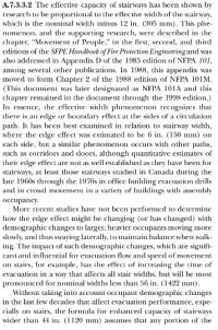

I've been reviewing the egress width requirements for various occupancies in the IBC and NFPA. I see a range of 0.15" per occupant to up to 0,5" per occupant depending on the use of space. Does anyone have access to the logic or rational for how the limits were created. I'm wondering is there were some sort of fluid dynamics type work done related to humans passing through doorways, etc. Any insights or links to background info would be greatly appreciated.

NFPA 101 Appendix has some background on their numbers. It also includes a warning about the data being old and probably not matching current demographics (aka we're fatter now):
