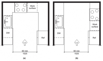

ICC A117.1 Section 804.5.5.1 reads:
"The oven door in the open position shall not obstruct the clear floor space for the oven."
how is this implemented? does this mean a bottom hinged oven door must be raised up to create toe/knee clearance?
If the bottom-hinged door is open, there is no way someone can occupy the floor space underneath. Thus, the clear floor space must be provided on either side of the oven door.
ok, but Section 305.5 reads:
"Unless otherwise specified, the clear floor space shall be positioned for either forward or parallel approach to an element."
does this not imply that the access to the feature (the internal area of the oven) be on one of the sides of the clear floor space? the pictures certainly indicate that if the words don't.
cda, I think you offered the best example by referencing that figure in the FHA manual.
In my opinion, the side opening door would be preferable with the required work surface on the side opposite of the hinge.
Check page 7.6
Actually the diagram on 7.13 shows a great solution. And why couldnt thd same concept be done with the oven? We had a wall mounted double in in our kitchen, with a large drawer below. Eliminate the drawer for knee space.
Forward approach is often the most reasonable. Although not shown in the picture below, an accessible work surface is required immediately adjacent to the oven. This is shown in the figure (A117.1 Fig. 804.2.1 and 804.2.2)
When you really think about it, every wall oven should be open from the side. You shouldn't have to lift a heavy turkey or roast over a door. A side swing oven allows easy access to the oven.
