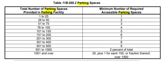

IN CA, NO
TABLE 11B-208.2 PARKING SPACES
TOTAL NUMBER OF PARKING SPACES PROVIDED IN PARKING FACILITY 4
MINIMUM NUMBER OF REQUIRED ACCESSIBLE PARKING SPACES 1

Mark, I've seen 2 projects here in CA where the ahj interpreted 11B-208.2.4 "for every 6 spaces, one must be van accessible" as meaning a handicap space is not required until you hit 6 spaces....5 or fewer are exempt.
That was an the DOJ interpretation back in the day of 2004 ADAAG.
Not Federally or CA Codified,
At this time, there is no exemption for CA.
The Table does not start at six spaces, it starts at one.
Thanks Mark. Just to follow up, the current table is the same as the 2004...even earlier. So even though the table has not changed, the interpretation has? And if I have 5 spaces, does that mean the accessible space does not need to be van accessible since it is fewer than 6?
VAN SPACE, NOT LESS THAN ONE
