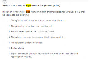

Looked at 2015, 2018 commentary, and 2021 code....Can't find anything definitive that cavity insulation can not satisfy the requirements for insulating pipes inside a building cavity....Anyone?

2015 IECC R403.5.3 Hot Water Pipe Insulation (Prescriptive)
Insulation for hot water pipe with a minimum thermal resistance (R-value) of R-3 shall be applied to the following:
  1. Piping 3/4 inch (19.1 mm) and larger in nominal diameter.
  2. Piping serving more than one dwelling unit.
  3. Piping located outside the conditioned space.
  4. Piping from the water heater to a distribution manifold.
  5. Piping located under a floor slab.
  6. Buried piping.
  7. Supply and return piping in recirculation systems other than demand recirculation systems.
Looking more at this:
N1103.4 (R403.4) Mechanical system piping insulation
(Mandatory). Mechanical system piping capable of carrying
fluids above 105°F (41°C) or below 55°F (13°C) shall be
insulated to a minimum of R-3.
And whether immersion in the envelope counts....It is specifically discussed for ducts, but for piping it is not and even the 2 sections for mechanical and domestic read pretty differently....
I have found most jurisdictions allow hot water pipes to be insulated by the cavity insulation. You still have to show there is enough thickness around the pipes to meet the R requirement.
