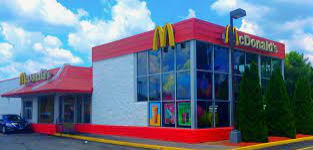

Years ago, some of the fast-food restaurants had play areas in just about every establishment. Yes, people do travel to the restaurant to use the play area and maybe purchase an ice cream cone in the winter here just so you have a warm place for the kids to play and the adults to sit.

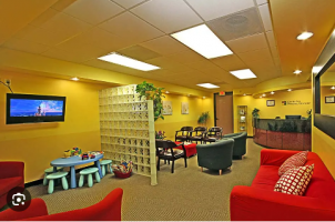

Can you clarify - - is the "play area" a completely separate room, like this?

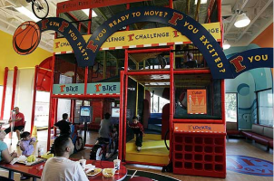

Or is it a screened, defined area within the main restaurant, like this?
Or is it just a few toys in the corner, open to rest of the restaurant?
