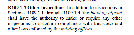

I have an accessory building at the predrywall inspection phase. I am siding the exterior with concrete fiber board fire rated 4x8 sheets with battens. Roof is dried in and tyvek paper is on the exterior walls. the walls are sheeted with 1/2" OSB. My inspector insists I need to side the entire exterior before he gives me a green tag for predrywall. He wants to inspect the nails before rock goes up. I have never run into this and have used this exact setup and schedule for 5 projects. Any advice and comment welcome.

Beside the required inspections in section R190 of the 2015 IRC the building official may require additional inspections
in addition the BO my have standards of what is considered weather tight, and compliance with the manufacturer's standards for sheathing or wraps left exposed to the weather, or the manufacture insulation requirements of the inter products being installed.
Could be you are new to the area, he doesn't know your work. Some AHJ's are very strict as to the order things get done and wants the weather protection in place before starting the insulation and drywall.
While the IRC may perform additional inspections there is a major difference between visiting the site at random times and imposing requirements that require the contractor stop work pending an inspection. In the later case it is imperative that the contractor have had notice of these inspections in advance.

Missing the point, he is looking for "shiners", nails that missed the studs. I have seen this in track housing where subs with nail guns blow through and it doesn't show until the stucco begins to crack, Good inspector!
I May agree to some extent. Here in NM we have a licensing system, the whole state is under the same code, and may be local policies that are more strict. The later is up to us to inform the contractor. All the required inspections shall be know by the contractor. If contractor calls with the required 24hrs notice we will be there. It is the responsibility of the contractor to know how to do his job & when to schedule thinks, not the AHJ's even when I was on the other side of the counter.
