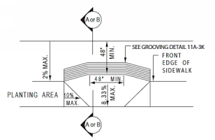

I believe that 11B/ADA 302.3 allows for max 1/2" wide grooves or even openings on accessible ground surfaces.
In fact, for privately funded housing accessibility (CBC 11A), the grooves are actually still required per CBC Fig. 11A-3K :

Grooves are no longer Required in CA 11B. They are not prohibited.
BUT are still in CA 11A
CA 1112A.8 Border
All curb ramps shall have a grooved border 12 inches (305 mm) wide at the level surface of the sidewalk along the top and each side approximately 3/4 inch (19 mm) on center. All curb ramps constructed between the face of the curb and the street shall have a grooved border at the level surface of the sidewalk. See Figures 11A-3A through 11A-3K.

What you show is not CBC 11B 2016 ?
Everything I showed in post #9 is CBC 11B 2016. There is nothing in there that prohibits grooves, or even openings per 2016 CBC Fig 11B-302.3.
If you have something different in your copy of CBC 2016, please repost the exact language and specific reference from the 2016 CBC. Thanks!
