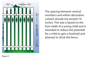

Where the barrier is composed of horizontal and vertical members and the distance between the tops of the horizontal members is
less than 45 inches (1143 mm), the horizontal members shall be located on the swimming pool side of the fence. Spacing between
vertical members shall not exceed 1-3/4 inches (44 mm) in width. Where there are decorative cutouts within vertical members,
spacing within the cutouts shall not exceed 1-3/4 inches (44 mm) in width.
{The intent is that there should be no horizontal surface greater than 1-3/4” which could allow a child to use as a foothold}

For the horizontal design to comply as a pool barrier, it would require the posts to be spaced no greater than 1-3/4 inch apart.
But the horizontal bars in the photos would not in your opinion?
Right. Horizontals can be at any spacing, but when they are less than 45 inches apart they cause the maximum spacing of the verticals to be 1-3/4 inch.
