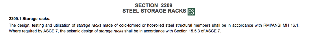

I'm curious.....what code sections would you cite, should you think the racking system is sub-standard?
It is not whether I "think" the racking system is sub-standard. It is more the fact that I am asking for proof of design compliance as required in the IBC.
Most plans that came across my desk already had a racking page with these specs and a data sheet from the manufacturer, those that didn't were usually the problem plans and after asking for proof of design compliance a small battle began as they were not aware there was a standard and were planning on installing an uncertified system. There is a cost difference of course but the battle was never long or drawn out.

It helps to have a familiarity with the structural provisions. IBC Chapter 22 deals with the design of storage racks. There are special inspection requirements for storage racks in Chapter 17 when required because of seismic loading.
The failure mode shown in the video is not addressed in the code. My guess is that racks designed for seismic forces will be less likely to experience the progressive failures of adjacent racks.
