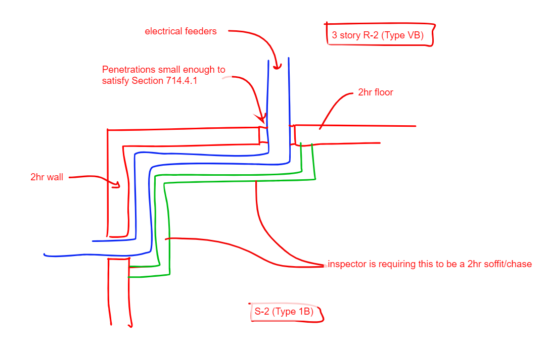

We have a 3 story R-2 (Type VB) over a S-2 (Type 1B) basement. Per 510.4 there's a 2hr floor between the occupancies.
We have feeders coming into the S-2 basement, and then routing up through the 2hr floor.
The local inspector is requiring us to build a 2hr hour soffit/chase around all the feeders inside the S-2 fire area.
From my understanding of the code, this is not necessary. Am I missing something?
The penetrations are small enough to satisfy 714.4.1.
If the through-penetration assembly is rated for 2-hours in a horizontal condition, then a rated soffit is not required.

Ask the nice local inspector for a code section.

Per the recent site photo below, it looks like the aggregate penetration is greater than 144sqin.--thus the reason, I assume, the inspector required a 2hr soffit/chase in the basement below.
Another question, per 714.4.1, do those cables need to be steel, ferrous or copper conduits rather than Romex?
If they stay Romex I assume, per 713.4, we need a 1hr shaft up through the 3 stories of TypeVB, R-2, correct?
Thanks, Ryan
Thanks, Ryan
The 144 sq. in. area limitation only applies as an exception to using a through-penetration firestop system or a method tested as part of the fire-rated assembly. If you use an approved fire stop system, there is no limitation.
Nice, that mentally unlocked it for me.
So back to the requirement of the chase/soffit in the S-2 (Type 1B) basement--one would assume the inspector did not think these penetrations had the appropriate fire stop system, and thus required the 2hr chase/soffit in the basement below.
