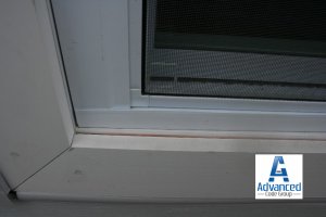

The house had a major renovation that included new replacement windows and vinyl siding with wood trim that was not capped with aluminum.
In this case the water runoff goes right behind the siding. Can you think of any IRC code section that would cover this?
For those that don't inspect this kind of work, and that is going to be your only comment, don't bother. Can we please discuss the issue at hand? Thanks.

Good one Jar, the classic failure to flash and use of dissimilar materials.
Replacement companies do this all the time.
R703.1.1 Water resistance. The exterior wall envelope
shall be designed and constructed in a manner that prevents
the accumulation of water within the wall assembly by providing
a water-resistant barrier behind the exterior cladding
as required by Section R703.2 and a means of draining to
the exterior water
that penetrates the exterior cladding.
