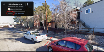

My condominium complex recently added fences with gates. We now have only 1 automated gate for automobiles that opens (the other 3 are permanently locked) and all 4 pedestrian gates are permanently locked (because people were propping them open.) The automated gate works with a Bluetooth app; the pedestrian gates have keyboards to take unlocking codes to enter. We have 167 units, at least 200 residents. This seems unsafe. I can't find the requirements for this in the code. Do any of you-all know? Thanks.

I have no site plan, but it's not complicated: 4 buildings separated by north/south driveways, a parking lot on the south side, an exit on the west side. All 3 north/south driveways used to be open; now they're all permanently closed. Only the west side has an exit, and that onto a street that dead-ends on the south side, so there's only 1 way for an automobile to get out.
Only a reference to code or law will make any difference. I watched a large apartment building burn some 45 years ago. I can imagine what would happen here, when 150 cars and 200 people all try to exit through 1 gate. I wouldn't even look at the code if it were my decision. At least all the pedestrian gates should open.
