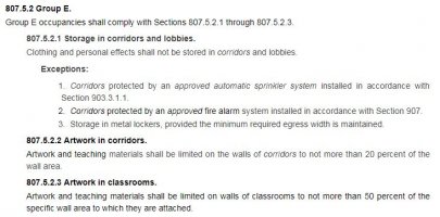

I know what the title implies, but I am not talking about corridors here. Classrooms. I am in virginia, you can find the virginia fire code here:
https://codes.iccsafe.org/public/document/VFC2012
Artwork on the walls within the classrooms, would you consider the following code section applicable to limit the amount:
807.1.2 Combustible decorative materials.
The permissible amount of decorative materials meeting the flame propagation performance criteria of NFPA 701shall not exceed 10 percent of the specific wall or ceiling area to which it is attached.
Exceptions:
  1. 1.In auditoriums in Group A, the permissible amount of decorative material meeting the flame propagation performance criteria of NFPA 701 shall not exceed 75 percent of the aggregate wall area where the building is equipped throughout with an approved automatic sprinkler system in accordance with Section 903.3.1.1, and where the material is installed in accordance with Section 803.11 of the International Building Code.
  2. 2.The amount of fabric partitions suspended from the ceiling and not supported by the floor in Group B and M occupancies shall not be limited.
We have a similar provision here in Canada, it is not enforced in classrooms, but is for the hallways serving the means of egress.
There's a little bit of a quandary IMO with existing buildings for allowances under the code it was constructed and allowances to permit such conditions as allowed under future code editions that may or may not be adopted and doesn't conflict with Virginia Administrative Code.
For example 2018 IFC, Section 807.5.2.3
Artwork and teaching materials shall be limited on walls of classrooms to not more than 50
percent of the specific wall area to which they are attached.

No the section does not support limiting decorations in the classroom.

106.5 Modifications. The fire official may grant modifications to any provision of the SFPC upon application by the owner or the owner’s agent provided the spirit and intent of the SFPC are observed and public health, welfare, and safety are assured.
Note: The current editions of many nationally recognized model codes and standards are referenced by the SFPC. Future amendments to such codes and standards do not automatically become part of the SFPC; however, the fire official should consider such amendments in deciding whether a modification request should be granted.
2015 & 2018 IFC SECTION 807 DECORATIVE MATERIALS OTHER THAN DECORATIVE VEGETATION IN NEW AND EXISTING BUILDINGS.
Kept meaning to look at 15/18 thought classroom was included

Note the 2015 and 2018 definition provided below has been revised for better clarification. The definition now clarifies "artwork" as decorative material and it also defines what is not regulated as decorative materials such as "wall coverings" and interior finish.
[F] DECORATIVE MATERIALS. All materials applied over the building interior finish for decorative, acoustical or other effect including, but not limited to, curtains, draperies, fabrics and streamers; and all other materials utilized for decorative effect including, but not limited to, bulletin boards, artwork, posters, photographs, batting, cloth, cotton, hay, stalks, straw, vines, leaves, trees, moss and similar items, foam plastics and materials containing foam plastics. Decorative materials do not include wall coverings, ceiling coverings, floor coverings, ordinary window shades, interior finish and materials 0.025 inch or less in thickness applied directly to and adhering tightly to a substrate.
! For those enforcing the 2015 edition it’s very important that you are aware that “Section 807.5 has been revised in the 2018 because the allowance to exempt occupancies listed in the section from their applicable special regulations based on complying with Section 807.2 is potentially dangerous. For example, based on the strict reading of Section 807.5 in the 2015 IFC, restrictions on the use of foam plastics in Group A are currently waived if you comply with Section 807.3. This was never the intent, and this revision corrects this section.”
