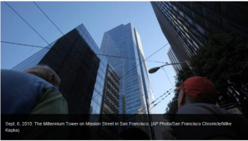

A newly built high-rise residential tower in San Francisco that's home to famed 49ers' quarterback Joe Montana and Giants' outfielder Hunter Pence is slowly sinking and shifting, and may ignite a court battle between residents and the city.
The 58-story Millennium Tower, located at 301 Mission Street just south of the city's financial district, was completed in 2008 and has sunk 16 inches and shifted 2 inches to the northwest since opening, according to a report issued by an independent consultant obtained by KTVU-TV.

The 60-story Millennium Tower is made of concrete rather than steel, resulting in a very heavy building. This heavy structure rests on layers of soft, compressible soil. The foundation of the Tower, however, consists only of a concrete slab supported by short piles that fail to reach the bedrock below. That foundation is inadequate to prevent settlement of a building with the weight of the Tower. In contrast, the Salesforce Tower and 181 Fremont Tower, also adjacent to the Transit Center, are supported on piles drilled down to bedrock. Millennium Partners’ poor design decision is the cause of the tilt and excessive vertical settlement of the Millennium Tower.
Here’s why the building is sinking, according to the TJPA
[...] When Millennium Partners started construction of the Tower in 2006, they knew that the TJPA intended to excavate adjacent to their building. Nonetheless, Millennium elected short piles that did not reach bedrock. The engineers who designed the foundation for the Millennium Tower predicted that the Tower would settle vertically a maximum of six inches over the life of the building. By the time the TJPA started work on its project in 2010, the Millennium Tower had already settled ten inches – four more inches than Millennium’s engineers predicted over the life of the building. The building has continued to settle vertically, now 16 inches, even after the TJPA completed the excavation for the Transit Center. A foundation of piles down to bedrock would have prevented.
As for the tilt, the Millennium Tower is now tilting northwest, away from the Transit Center, and that tilt is only going to get worse. “Again, had Millennium Partners invested in piles extending to bedrock, the Tower would not be tilting today,” slaps back TJPA.

My belief that when the dust settles we will find that the safety of the building is not compromised and that some work will be done to adjust the grades at the entrance to the building and to compensate for the impact on adjacent utilities in the street.
Original design had contemplated 4 to 8 inches of settlement. While 16 inches is more than expected there should be no safety concern unless there is ongoing settlement.
Some have been concerned about the report that the building is 2 inches out of plumb. I suggest that this may be less than construction tolerance for a 58 story building. It is definitely less than expected wind drift.
Bottom line this is a tempest in a tea pot.
