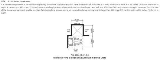

Hi,
We are arranging our restroom units. However, we are not sure about the heights of shower control units. Shall we consider ADA standards or is there any item in ASME A112.19?

Also there will not be any disable person in these rooms. However, we want to compare the standards and select best applicable version.

So, per the IBC, you would typically have some Type A units. For those units, A117.1 Section 1003.11.2.5.2 will send you to Section 608. Below are the requirements for the two most common shower types (transfer and standard roll-in).
For Type B units, follow A117.1 Section 1004.11.3.1.3.3
