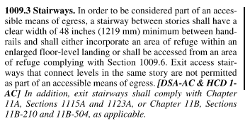

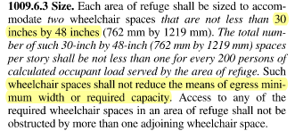

I realize the the question was probably asked from a life-safety standpoint, but there are several other accessibility factors that might make the landing even larger than 5'. Keep in mind that:
(a) a wheelchair user might enter the stairwell, realize this is not for them, and need to turn around and go back out the door they came in.
(b) An "accessible means of egress" system might (or might not) include an enlarged stair landing per 1009.3 and 1009.6:
You can see how this could easily become (30"+ 44") or even (48" + 44").
