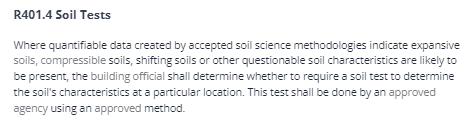

After, that California Residential code R401 gets much more specific about geotechnical reports:
R401.4 Soil Tests
Where quantifiable data created by accepted soil science methodologies indicate expansive soils, compressible soils, shifting soils or other questionable soil characteristics are likely to be present, the building official shall determine whether to require a soil test to determine the soil's characteristics at a particular location. This test shall be done by an approved agency using an approved method.

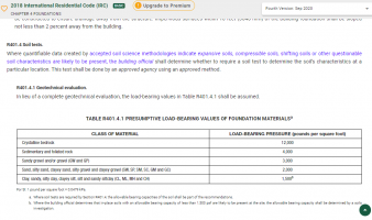

R401.4.1 Geotechnical Evaluation
In lieu of a complete geotechnical evaluation, the load-bearing values in Table R401.4.1 shall be assumed.
TABLE R401.4.1
PRESUMPTIVE LOAD-BEARING VALUES OF FOUNDATION MATERIALSa
CLASS OF MATERIALLOAD-BEARING PRESSURE
(pounds per square foot)
Crystalline bedrock12,000
Sedimentary and foliated rock4,000
Sandy gravel and/or gravel (GW and GP)3,000
Sand, silty sand, clayey sand, silty gravel and clayey gravel (SW, SP, SM, SC, GM and GC)2,000
Clay, sandy, silty clay, clayey silt, silt and sandy siltclay (CL, ML, MH and CH)1,500b
For SI: 1 pound per square foot = 0.0479 kPa.
  1. Where soil tests are required by Section R401.4, the allowable bearing capacities of the soil shall be part of the recommendations.
  2. Where the building official determines that in-place soils with an allowable bearing capacity of less than 1,500 psf are likely to be present at the site, the allowable bearing capacity shall be determined by a soils investigation.

R-401.1 exists in the International Residential Code, not just California's version of it:
