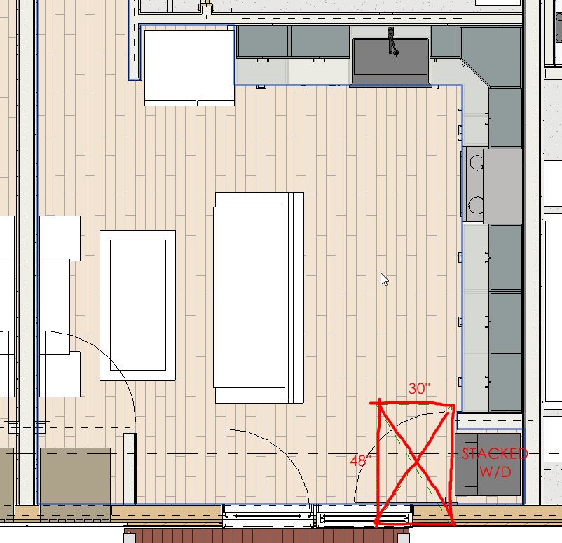

From my understanding, they make stacked washer/dryers that are ADA compliant.
Assuming that is correct, with a stacked washer/dryer arrangement in a Type B Unit, can the 30"x48" clearance be a forward approach, or would it need to be a parallel approach centered on the fixture, as illustrated below? Thus, we would need to make this closet wider, as a result.
Hmm... the unit in my first post is noted as being ADA compliant, but it doesn't seem to meet the following for the dryer unit above.

Forward or parallel approach will be limited by the loading of the appliance. This comes from A117.1-2009 Section 611.2
Ok, reading a bit more, the manufacturer only describes the washer (the lower unit) as being accessible.
I am not sure that one could do a stacked accessible unit, as the loading for both must be no more than 36-in above finished floor.
Maybe a combo washer/dryer unit?
even though I can find stackable washer/dryers that claim they are ADA accessible, I'm not so sure they really can be. It seems the top dryer door would be too far up to reach.
Yeah, that manufacturer's description is pretty deceptive, if you have to dig deep to figure out that only half the assembly is accessible. I don't see how a stackable arrangement would ever meet accessibility standards.
Upper unit would be, but I have seen the lower unit as a top load.
Yep....But access to both would be required....The front loading offset is a max...Its actually the centered top loading that is going to get you in trouble in your pic...You said type B? So clear floor space is in play, but not reach ranges.....Interesting.....

I would think the foot holders or the push handles of the wheelchair would make it difficult to use the stack-able W&D in your first post plan and you haven't provided enough space to meet the requirements for ADA access? IMO
How bout reducing the three cabinets to two, and moving the W&D, move one of the cabinets to the wall side, then it can be used as the laundry cabinet for soaps and clothes baskets in the base cab? Wall between kitchen cab could also be moved or reduced in width if needed. I think you could still get a door or cabinet face frame to hide the W&D?

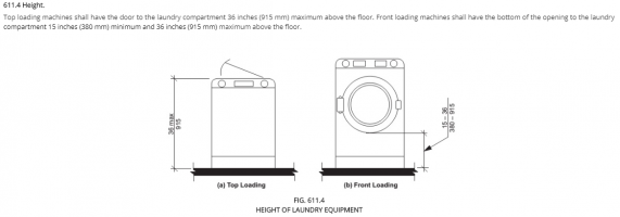

Yes, if you are doing an ADAS / CBC 11B laundry area, reach ranges make it virtually impossible to have a stacked unit comply.

There are currently no ADA compliant stacked washer-dryers available on the market. There may be FHA compliant stacking combos, but not ADA.
That's because per ADAS 611.4 the range of allowable height range for the bottom of the door opening on washer and dryers is 15"-36". Even the smallest recreational vehicle-sized stacking washers and dryers can't get both of their stacked doors to fit within that 21" range.
There are all-in-one combo units available, but that is not the same as stacked. Most of those are condensing instead of vented dryers, and of course you can't wash and dry simultaneously, which is out of compliance with comparable facilitation of unit amenities in multifamily housing implied by ADAS 233.3.5.
