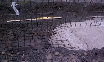

    This is a trench pour that was not finished. This is the day after.
    Thoughts?

    Require the RDP's sign off..........

    It''s pretty close to being the kind of roughed-up surface that RDP's like to see at cold joints.

    I thought the same thing, but would still want the RDP's sign off.

    need detail for joint condition or nobody will sign off. May not need detail, a document before completing for best results in getting sign off.

    Impalement protection?

    Too much rust ( i.e. - scale ) on the bars, ...some intersections not
    tied together, ...reinforcement not fully supported throughout to
    prevent deflection during the placement.

    My sense is that the concrete foreman either did not have a lot of experience or just did not give a dam. Since it appears to be a commercial project it is likely that there is an engineer who should be asked to create a detail. Many projects have a detail for a construction joint.
    My initial bias is to remove the thin layer of concrete

    Don't like the block in the footing to larger of a void. The cold joint is sloppy. IMG_2219.JPG
