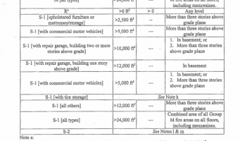

there are two, about 5,000 SF and one 6,800 SF. all with proper egress( and signage) and an addressable alarm system (heat and smoke detectors). both under MA general law 7,500 sf sprinkler mandate.
If they are under the sprinkler mandate, why are they being mandated? Close together? Treated as one building?
Chapter 9 of the 2015 IBC with Massachusetts amendments are in play,
