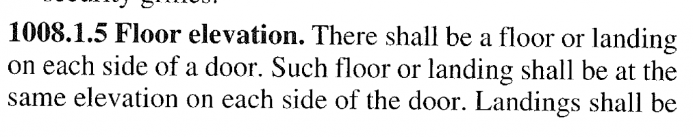

I'm working on a parking deck project and due to a precast mishap the door to the stairwell/elevator lobby sits in a concrete wall opening that is 1 inch higher than the landing surface. My thought was to use one of those aluminum threshold-style ramps at the base of the door to allow a smooth transition down to the landing. Only problem is the code would require a level landing at the top and bottom of the ramp for maneuvering/etc. I really want the ramp to just go right to the base of the door similar to any other threshold arrangement. This ramp is all of twelve inches long, do I really need a top landing?
Before you suggest grinding down the concrete, we've already done that. Originally the difference in elevation was 2 inches. We got it down to 1 inch and we can't grind much further.

Anyway, you need to talk with the AHJ/Inspector that will be signing off on it. He might not require the landing,I don't know if that would make it better, or worse. Just a bad situation.

I would suggest floating the floor to 1:20 its only 8 more inches and then it is not considered a ramp but just a walkway with no top and bottom landing being required.
my 2 cents
A picky inspector would not allow you to "slope" the landing...
1008.1.5 Floor elevation. There shall be a floor or landing on
each side of a door. Such floor or landing shall be at the same
elevation on each side of the door. Landings shall be level
except for exterior landings, which are permitted to have a
slope not to exceed 0.25 unit vertical in 12 units horizontal
(2-percent slope).
