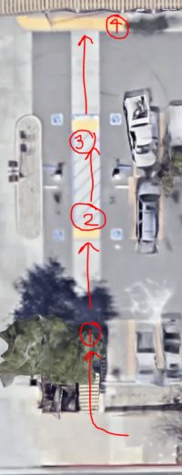

I wish the photo turned out better! This is the POT from the sidewalk to the front entrance at our little Target store that I walk past every day just shaking my head.. There are 7 instances of where you will encounter detectable warnings on your adventure across the parking lot. Should only be 2. This is what happens when people that do not understand how visually impaired people use these warnings. The first section of domes at the sidewalk edge indicates your in a vehicular way and then a few feet later you hit the next set and for the impaired now believe you are no longer in the vehicular way. But this is now crossing the drive aisle! And it repeats its contradiction all the way to the front door. Terrible misuse of detectable warnings. I see this all the time where they believe more is better. It is just confusing and potentially dangerous.

The photo below is a retail parking lot in California that utilized the accessible parking loading/unloading aisles to do double-duty as the accessible POT from the public sidewalk to the front door. As a result, it has 4 different detectable warning in less than 100'.
This is because each parking lot drive aisle is "vehicular way", and each row of blue-striped ADA parking stall loading spaces is not a vehicular way.
Coming up from the public sidewalk (bottom of photo), warnings #1 and 3 let you know each time you are about to cross a drive aisle.
In the other direction, when exiting the building (top of photo), warnings #4 and 2 tell you when you are about to cross a drive aisle.​
I asked a friend who is 100% blind how he keeps track of whether the warnings are telling him he's entering vs. leaving a vehicle area. He said at his school for the blind they teach that detectable warnings are generally worthless and confusing and should not be relied upon at all.

locations 2 and 3 should be eliminated. Don't get me started on diagonal curb ramps!! I have rescued several blind people from the center of intersections after they use the curb ramp for orientation and are now walking diagonally across the intersection!
I don't agree that this is a misuse. They are placed to alert people when they are entering and leaving vehicular traffic crossings. I think that is an appropriate use for detectable warnings (truncated domes). See A117.1-2009 section 406.14. A117.1 doesn't explicitly call for them at such level crossings, but such crossings are not unlike a curb cut-through as illustrated in Figure 406.11(a).
Not really my area of expertise but it seems to me that the domes at the interface between the sidewalk and the parking lot should be the last set of domes. The path and the entire parking lot is prone to vehicular traffic. A second set of domes as shown in the picture would confuse a blind person and lead them to believe that they have exited the area of vehicular traffic.

Code Chronicle, my example and several posted after it are a complete misuse of truncated domes and can endanger the blind. no detectable s should be used within the parking area typically. There could be a highly unusual situation that calls for it but not the situation that I showed.
And Mark, I fully agree that is seriously wrong
I also agree with Mark and JPohling. The image in the original post is very explicitly against current CBC requirements (mentioning CBC because the OP is in San Diego).
11B-502.4 Floor or Ground Surfaces (this is for access aisles)
Parking spaces and access aisles serving them shall comply with Section 11B-302. Access aisles shall be at the same level as the parking spaces they serve. Changes in level, slopes exceeding 1:48, and detectable warnings shall not be permitted.
