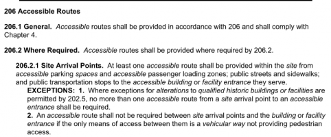

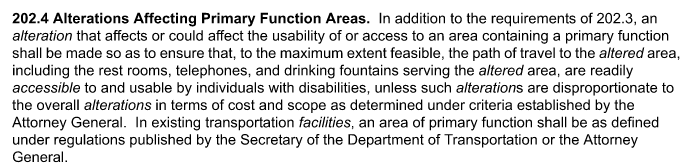

The excerpts below are not ANSI 117.1, but ADA Standards 206.2.2. You'll have to see if ANSI has something similar.
So it appears to me in ADA that building an addition onto your existing building does not necessarily mean that you must provide an accessible route between floors. The accessible route requirement in 202.4 is from the public right of way (and from parking, restrooms, etc.). going into the addition.
It does appear that the normal requirement is to provide an accessible route to connect accessible spaces within a site (206.2.2). In your situation, this implies an accessible exterior route between the upper story entrance and lower story entrance.
The exceptions for both of the previous requirements have to do with a site where the only means of access is a vehicular way not providing pedestrian access. Your site may be steep enough that this is your only option. However, in your original post you said "Employees could walk the 20 ft wide paved path (greater than 16% slope at some points)". I think this undercuts your case for avoiding construction of an accessible route. You are implying that the owner intends for the driveway to also function as a walkway for most able-bodied employees.
