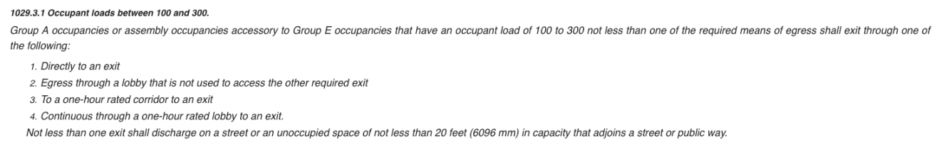

So assuming we need to create a common corridor access to both stairs, that opens up another question relative to this specific tenant space. You'll notice in the plan, there is a large training room (highlighted in yellow) with an occupant load of 167 occupants. This is obviously an Assembly occupancy, but is less than 10% of the floor, so it would be Accessory to the Group B primary occupancy classification.
Question: Does 2019 CBC Section 1029.3.1 apply to that training room, OR does the fact that it is Accessory to Group B provide an exemption?
This plays into whether the new corridor we have to create on this fully sprinkled 4th floor would need, at least a portion, to be of 1-Hour rated construction?
