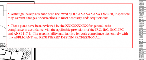

What kid of disclaimer do you use on the plans you stamp as a reviewer/code official letting the contractor know the field inspector may require additional work if required by code?
Show us your stamp or verbiage.
"Whatever I missed, the field inspector will correct"
"No attorneys please"
Or the other one
""" Comply with IBC""""
REVIEWED FOR CODE COMPLIANCE
It shall be the duty of the permit holder or their agent to notify the building official that such work is ready for inspection and obtain approval prior to such portion being covered or concealed. Person requesting the inspection shall provide access and means for the inspection of the work.
Permit No.:______________ Date:__________
We do not mention that the inspector might have corrections for the work or the plans. They're usually not all that surprised.
[A] 107.3.1 Approval of construction documents.
When the building official issues a permit, the construction documents shall be approved, in writing or by stamp, as “Reviewed for Code Compliance.
That is all that is required so that is all that we put on the drawing

I like the simple stamp for "reviewed for code compliance", but the disclaimers are more and more becoming a part of the process. I know it's silly today but I expect the applicants to know things like the fact that the inspector can still make a call. If I had my way (I don't) I would keep them to a minimum.
