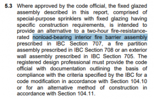

I have a wood-framed type V-A apartment building design where two of my emergency escape windows face into a courtyard that is less than 10' wide, and therefore my 1-hour loadbearing wall and its openings require protection per CBC 1028.4.2. I planned on utilizing the water curtain for 45 minute protection per CBC 705.8.2 (exception). Although this project is not in Los Angeles, LA has a pretty good information bulletin explaining how this works: http://www.ladbs.org/docs/default-source/publications/information-bulletins/building-code/water-curtain-in-lieu-of-protected-exterior-openings-ib-p-bc2014-106.pdf
My plan checker is saying that I can't use a water curtain in a loadbearing wall, because NFPA 13 8.15.26 now says that water curtains are allowed only in nonloadbearing walls. Likewise the ESR-2397 for Tyco sprinklers says that water curtains are intended for use in nonloadbearing walls.
However, a header goes over the window; therefore everything below the header (including the window) is already non-loadbearing; so I should be allowed to use the water curtain substitution, right?.
What do you think?
The reference is to a loadbearing wall, not a loadbearing opening. If the wall in which the opening is located is loadbearing, then the sprinklers cannot be used for opening protection.

After reviewing ESR-2397, it refers to use with non-load-bearing interior fire barrier assemblies, a fire partition, or an exterior wall assembly. Seems to me, that the only requirement for non-load-bearing walls pertains to an interior fire barrier.
However, per NFPA 13 8.15.26 (5), it does not specify.
Based upon NFPA 13, it would thereby be IMHO not permissible to use a water curtain as proposed (agree with plans examiner). A header does not constitute justification for a wall being non-load bearing. Load bearing walls by very nature have headers within them.

Don't both NFPA 13 8.15.26 and ESR-2397 5.3 specifically require the glazing to be fixed? How is an EERO fixed glazing?
