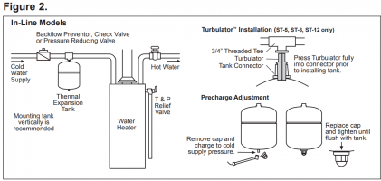

It may be upsidedown too
Installation
1. Install the expansion tank on the cold water supply line to the water heater at a point between the water heater and backflow preventer or other one-way device (Figure 2)
WARNING!
Mount vertically in downward position only. Ensure that tank is supported properly to hold the entire weight of the tank when full of water.

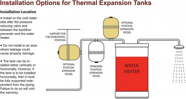

We see expansion tanks mounted in multiple configurations. Be sure to check the manufacturer's installation instructions before writing a correction.
(Below are examples from 2 different manufacturers. )
I have been in contact with an expansion tank manufacturer (don't recall which one) and I was told that there is no wrong way to install the tank as long as it is supported....the pipe is considered sufficient support. As I recall there is a minimum distance away from the water heater .... but that may only apply to gas fired appliances .... or perhaps I made that up.
