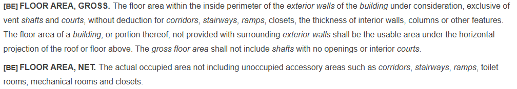

What load factor do you use for Restrooms?
I have in the past, used a zero load factor for these--categorizing them as circulation.
My AHJ hasn't seem to have a problem with that.
Depends on the main occupancy to which the restrooms are accessory.
If an assembly use, then only the net floor area is used and areas such as circulation and restrooms are not included. However, if the occupant load factor is based on gross floor area, then circulation, restrooms, etc. are included when determining occupant load.
Thus, if the restrooms are within an office building, then 100 gsf/occupant (150 gsf/occupant per 2018 IBC) is used. If it's a warehouse, then 500 gsf/occupant is used, and so on.
Let's say the main occupancy of the building is a (Airport terminal - Baggage claim) which is at (20 gross/occupant). Do I then need to use a (20 gross/occupant) for the restroom areas that serve that Baggage claim?
Seems high.
Airports can be a little tricky. Airport terminals are typically considered "covered mall buildings" and the occupant load of the "mall" portion would be determined per Section 402.8.2. If the restrooms are accessed from the "mall" circulation and not directly from the baggage claim area, then I would not include them as part of the gross area of the baggage claim area.
