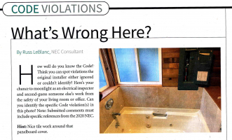

What's wrong here?
I saw that over on DSL Reports and had a good laugh about it. I'm sure everyone here will also get a good laugh. Obviously, somebody didn't pull a permit for that job!
They did not caulk around the tile under the circuit breaker box, might let moisture in
Looks like an "ol" Zinco panel, based off the flippers. It depends on if that jurisdiction has adopted modern day codes?
Current code: Service disconnects are not allowed in bathrooms, 2020 NEC 230.70 (2)
