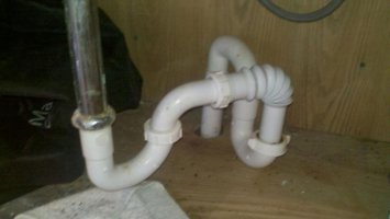

    Pennsylvania does not have any competency based statewide licensing of building contractors, none of the trades whatsoever.
    In Pennsylvania, if you just pay a $50 fee to the state and get an insurance policy (most are under $400) you can wake up in the morning and decide you are a contractor, no experience necessary. There are only a few cities that have any sort of competency based licensing and the Pennsylvania contractor registration law prohibits any municipalities from requiring competency based licensing if they did not already have a program prior to the contractor registration law.
    Here are some examples of the great work performed for customers by Pennsylvania contractors:
    Here you see the great double trap (an S and P trap all in one) done by quality Pennsylvania plumbers.

    Gotta love that vent

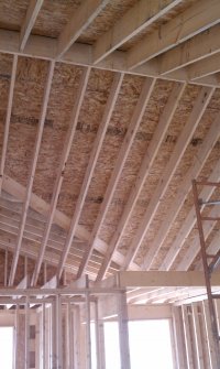

    When you use a ridge board instead of a ridge beam and think you are going to have a great looking cathedral ceiling but instead have an unsafe, sagging structure. This is the result of not having any training or competency based licensing of contractors in Pennsylvania.

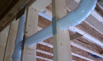

    A lack of competency based licensing of contractors in Pennsylvania resulted in this pathetic plumbing installation through the studs of a bearing wall between the garage and interior of this new home. Pennsylvania builders pride.

    I don't know what you are talking about....In post 9, you need to be a really good plumber to bore that large of a hole that close to the edge of a stud without blowing it apart.....Or maybe just have good sharp holesaws...

    Steve ... look closely at the stud on the left, the one closer to the T. Or Y, whatever. Anyway ... do you see two concentric marks on the wood? Like maybe the holehawg bound up and spun the drill motor and the plumbers arm?

    What weird thing is going on with the nails at the stud to top plate?

    Bad toe nailing....

    That is a pretty good "how much can be wrong in one picture" picture.....
