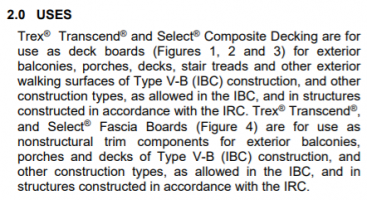

What you have is not a balcony by older code definitions, they are not defined in todays codes. However every ESR report I have read in the past for plastic composite deck boards limit their use to a V-B construction. Here is the current link with some new manufactures products. Perhaps you will find one that will work for Type III or V-A construction.
Looked it up, in the 2015 IBC it says that Plastic Composites shall be permitted in VB construction, but in the 2018 IBC it was changed, and now says that Plastic Composites shall be permitted where combustible construction is permitted.

Yes the IBC 2018 states that however the ESR report will limit its use to V-B construction or the IRC. Unless you can classify your project as a V-B construction type plastic composite decking is not permitted. A PE is not the AHJ and does not have the authority to accept anything contrary to code or an ESR report. He can give an opinion but in this case it would have no more weight than anyone else's opinion
SECTION 1409
PLASTIC COMPOSITE DECKING
1409.1 Plastic composite decking.
Exterior deck boards, stair treads, handrails and guards constructed of plastic composites, including plastic lumber, shall comply with Section 2612.
2612.5 Construction requirements.
Plastic composites meeting the requirements of Section 2612 shall be permitted to be used as exterior deck boards, stair treads, handrails and guards where combustible construction is permitted.
2612.6 Plastic composite deck boards, stair treads, handrails and guards.
Plastic composite deck boards, stair treads, handrails and guards shall be installed in accordance with this code and the manufacturer’s instructions.
This is just one example where a manufactures installation instructions can be misleading if you do not read the ESR for a specific product.
