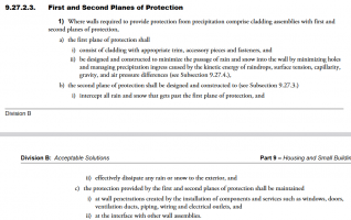

I have a multi-unit residential under the BCBC, Pt9.
We are not in a wet zone so rain screen not required.
Do you think the cladding and flashing detail shown is code compliant?
I would personally do it differently, but I believe it may meet strict code requirements as holes in the first plane of protection are minimal, and any penetrating moisture is directed to the second plane of protection.
Thoughts?

The A440.4 installation standard requires drip cap flashing anywhere where there is a secondary plane of protection, or where there is a concealed barrier. In this instance, we have a concealed water control barrier (the building paper), so drip cap flashing is required.
Probably one of the poorer installations I have seen. They've all but guaranteed water will run into the window opening.

It must look strange as well as collecting debris at the top. The window appears to be designed for a particular cladding and the siding as shown is not it. Another concern is that the flashing, flange and tyvek should be shingle fashion... this is the opposite of that.

Yes. The rarely seen "funnel" water management system.
My bad. I posted photos of 2 different windows. One has the drip cap, end dams etc. The other is directly under a roof. Bad posting
