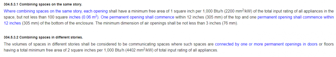

To utilize indoor combustion air, there must be 50 cu.ft. of space volume for every 1,000 BTU/hr input rating. (304.5.1)
Can the ceiling be omitted in a janitor closet to utilize the air space between the first floor office area ceiling and the second floor deck as combustion air?

First, I am not sure the proposed would comply with the high/low opening requirement of 304.5.3.1.
PA-FGC (2018 IFGC) 304.5.3.1 Combining Spaces on the Same Story
Where combining spaces on the same story, each opening shall have a minimum free area of 1 square inch per 1,000 Btu/h (2200 mm2/kW) of the total input rating of all appliances in the space, but not less than 100 square inches (0.06 m2). One permanent opening shall commence within 12 inches (305 mm) of the top and one permanent opening shall commence within 12 inches (305 mm) of the bottom of the enclosure. The minimum dimension of air openings shall be not less than 3 inches (76 mm).

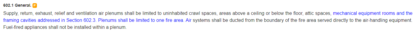

Second, I would be concerned that you are creating a plenum. While not using forced air, the intent to draw air through this concealed ceiling space for use as combustion air is unique.
You're asking if you can use fir first floor ceiling plenum as the source for combustion air? That only gives you an opening at the top -- how do you fulfill the opening at the bottom?

Like everyone else said, you don't have the bottom opening. Both the bottom and top openings need to open into the same adjacent space, so not possible to use the space above the lid. To use the one opening from a different level, you would have to go all the way through to pull air from the floor above. Even if you could count the space above the lid but below the floor, it would have to be a VERY large area to provide any meaningful amount of combustion air, depending on how tall that space is.

If there's a drop ceiling, this proposal isn't creating a plenum, it's trying to use the ceiling plenum as the source for combustion air. Aside from the high/low openings issue, the next question is whether both supply and return air are ducted, or is the ceiling plenum used as a plenum return. If it's a plenum return, then opening the janitor's closet ceiling to the plenum would result in the return air system pulling air out of the janitor's closet rather than introducing combustion air into it. And I don't think you would want the air from a janitor's closet to be recirculated, anyway (although I guess it's not prohibited by the IMC). Even if it's allowed, it's going to mess up the system balancing.
I do not think Section 304.5.3.1 will not work either as there is no low opening. However, there is no high wall opening either; the ceiling would be removed and airflow would be vertical, not horizontal.
It seems more suitable, to me, to consider Section 304.5.3.2 Combining spaces in different stories as the ceiling in the janitor's closet (water heater location) would be removed and the 4+ ft mechanical space above the ceiling would be the space from which combustion air is drawn. The ceiling space is part of the same story, not another story, so perhaps this section does not apply. The commentary is silent about utilizing the ceiling space.
I am hesitant about utilizing the ceiling space. As classicT pointed out, this could be a plenum and part of me wonders if the wiring and piping above the ceiling would then need to be plenum rated.

The ceiling is not a return air plenum. The office spaces utilize drop ceiling tiles. The two toilet rooms border the janitor closet on three sides and the toilet rooms utilize gyp bd ceilings. The corridor on the 4th janitor closet wall utilizes a drop ceiling.
Since the ceiling cavity is not a different story, there's no "perhaps" involved. The section discussing combining spaces in two stories clearly does not apply.
So a car dealership uses a ducted return air system? I'm amazed.

One of our clients specifically does not want plenum ceilings in their non-dealership buildings because they do not want to deal with ratings for plenums.
