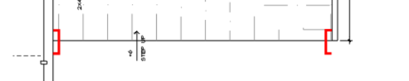

2.) Decks, patios and walkways that have a single change in elevation where the landing depth on each side of the change of elevation is greater than what is required for a landing do not require handrails.
Please explain a scenario where this exception applies.
Here is my example. A sidewalk that goes around the back of the building and then goes down 4 risers to an 8' landing. Does this require handrails on both sides or does that fit Exception 2?

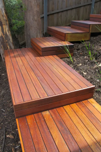

I found the spacing to be very awkward as it made me alternate between 2 and 3 steps per riser.
I love the look of such cascading steps/platforms/whatever, but you’re right, the variation in stride is weird. What’s worse is when the spacing between the risers requires an adjustment in stride, such as 1.5 or 2.5 normal strides.
