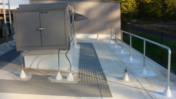

So what determines if the anchors are placed properly in relation to the unit or roof edge? Since they are about 4 1/2' from the roof edge, do you need another farther away to get to it? Is this system too close to the edge? Old school black rubber roofs are bad enough with a layer of frost or thin ice, White membrane roofs like this can be downright scary even if you don't have to worry about sliding over the edge. HVAC service techs aren't part of a construction crew. They are usually there alone, sometimes after hours. There might be no one to find them hanging over the edge for hours.....
Does this one meet code? The anchor is about 17' away from the farthest fan. Switch this to a square package heating/cooling unit 3' from the edge with no parapet. Where do you put the anchors to service the side closest to the edge? One thing OSHA does say is the lanyard connecting the vest to the anchor can't go around sharp corners. I would put the corner of a square unit in this category. BTW, its about a 70' drop over the edge.

So where do the permanent anchor points get placed in relation to the roof edge and unit? Most package HVAC units require maintenance on all sides, not just where the controls are. You can't have an anchor point on the side away from the edge to get to the side closest to the edge because by OSHA the lanyard can't go around sharp corners. The instructions I've seen for anchors recommend placing them 6-10 feet from the edge.

The cable disappears into the snow under the copper pipes in the second picture and runs under the pipes all the way past the second unit on the left, by the person in the picture. Beyond that, it re-emerges for the 4 foot stretch visible to the right of the unit in the third picture, then is lost again. Even without the snow, its located below the piping at the location where it is closest to being needed.
