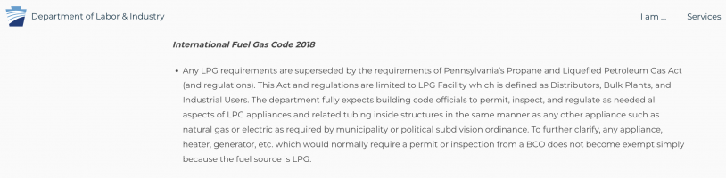

Right from the Department of Labor & Industry, in black and white, on their webpage as clear as day with no doubt about what inspectors are supposed to be doing. I got tired of arguing about this when I was in PA so here it is for all to see.
This was always confusing, because there were multiple State sponsored training programs that taught the opposite of this.
PHRC Guide to UCC
I am glad to see they finally clarified this.
