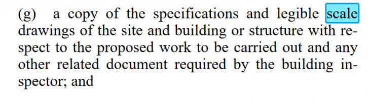

Why "cannot be scanned"? Is it purely a legibility / resolution issue? Or are you also requiring additional properties, such as word searchability?
