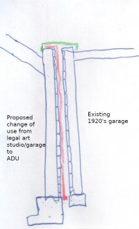

This is a tale of two adjacent lots with long driveways. On one side is a 1920's garage, and about 3 inches away the wall of a 1980's era "art studio" built with permits on a new foundation.
The shared wall space is 10'x20'.
Jurisdiction is in California.
Now the art studio is proposed for an ADU. I was expecting the building official to require the art studio wall to be upgraded to a 1-hour listed assembly -- which is plenty hard right there on a finished building. But they're requiring a 1 hour separation on each side of the property line. And that's a new one.
Both buildings have wood slat siding, the 1920's half is true dimensional lumber with no finish inside.
Is there a code basis for such a requirement? What if the neighbors, um, don't want to?

As a non-Californian, my view is that this is a case for the courts to decide. I can't see anything in code or in common law that allows a property owner to do something on his property that would require a neighbor to change anything.
Conventionally, the BO should only be able to make requirements for the building that the permit concerns. The other building, on separate property, would be allowed to remain as is.
I concur with the above; the only time I consider what is on the other side of a property line when doing spatial separation calculations is if the other side of that property line is

Neither the BO, the applicant, nor the courts could impose a required change to the neighbor's property. I think the code is pretty clear on the requirements. If it's a CRC design, then table R302.1(1) tells you that your exterior wall that has a fire separation distance of less that 5 feet shall be "1 hour—tested in accordance with ASTM E119, UL 263 or Section 703.3 of the California Building Code with exposure from both sides. If for some odd reason it was a CBC design then 705 would produce the same result, albeit in a much more thorough way.

Table R302.1(1) tells you that your exterior wall that has a fire separation distance of less that 5 feet shall be "1 hour—tested in accordance with ASTM E119, UL 263 or Section 703.3 of the California Building Code with exposure from both sides.
If I have to get the neighbor's permission to demolish and rebuild their garage, getting to 1 hour rating is easy. Without that, it's really.... remarkably hard....

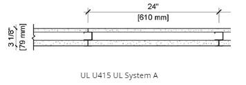

UL U415 UL System (3.125 in. thick STC 34) might work:
Except then the existing wall is outside the fire envelope, and the roof has to be supported with new posts or columns. Messy.

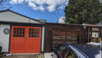

From the OP: the actual buildings.
Both were built with permits in their respective eras - 2002 and 1020. The left is the art studio/garage with room for 1 car, but never actually used to store a vehicle of course because hardly anyone 'round these parts bothers to garage a car.

You're absolutely correct. Probably easier to knock down the "art studio" and start fresh. Even easier to let good enough alone and leave it as is.
But if you want more housing then do it right. Sure, it's only a 150 sq. ft. building, but it adds value to the property and whoever inherits it or buys it later is going to assume it was done correctly. If you can't tear it down and start fresh, and can't get the wall rated from the outside, then you need to hire someone with a stamp and have them design an equivalent assembly. Preferably someone who can present it to he AHJ in an easily digestible manner and present how it meets equivalent safety. For example, maybe they would allow you to install a fire sprinkler system in-leu of a fully rated assembly? I don't know but that sounds reasonable to me...
