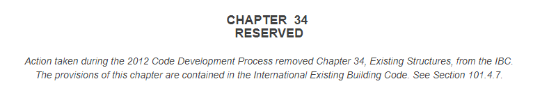

Greetings all !
The 2012 IBC has a Section [ RE: 1103.2.2 ] for Accessibility requirements
for Existing bldgs........I cannot locate this Section in the `15 IBC......Is there
an applicable Section in the `15 IBC for Existing bldgs. ?
Thanks !
Thank you Francis ! :)
I am looking for Links \ Code Sections from the `15 IBC and \ or the `15 IEBC
that addresses Accessibility in an existing building that is being renovated.
The RDP has not provided anything that addresses the exterior Accessibility
conditions.
Should I be requiring the assessment of the exterior Accessibility conditions
on an interior renovation ?
If possible, please provide info, Code Sections or other.
Thanks !
Francis, I hope you don't due your plan reviews looking at this size font? This is hard to see!
Again, ..."Much Thanks" Francis !.......That Section 410 is the one
I was looking for.
I have sent a Comment requesting a status of the exterior Accessibility
conditions.
