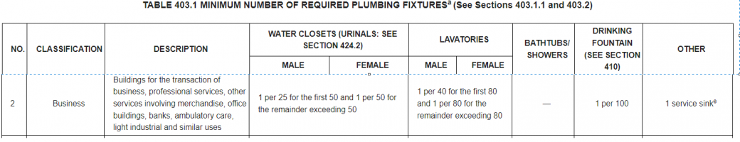

I have a Reviewer requiring two water closets per 403.1 for 17 occupants in a B occupancy. It's a chiropractors office.
I'm befuddled because I've never had anyone push for a second RR under 25 occupants. When I read Row No. 2 for B Occupancies, the box outlining the required number of Water Closets is shared across both Sexes, to me inferring that there's no requirement to separate the calculation.

funny, I'm looking at exactly this topic, and by no means am I an expert, but if you have 17 total occupancy limit.
17/2=8.5 each gender
So, 1 RR for the first 8.5 MALE (1 per 25)
1 RR for the first 8.5 Female. (1 per 25)
Grand Total: 2
That's my current understanding of when the table uses a single ratio without any separation in that box. It's just saying: calculate the w/c ratio TWICE for BOTH sexes once the total occupancy has been divided in half.
I can also see going with the grand total of 17 and reaching the single unisex Restroom calculation too, but maybe that's now how the reviewer is calculating it.

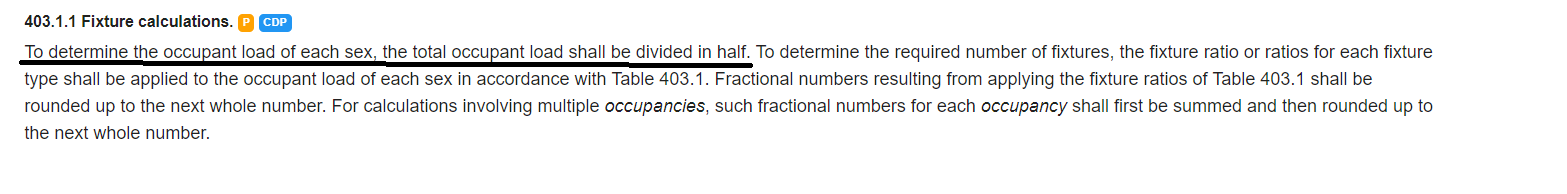

My thinking is that 403.2 means that even if there are 2 restrooms required, they don't have to be segregated by gender if it's under 25 total occupancy.
But 403.1.1 can be interpreted to just divide the total occupancy in half and apply the ratio to both genders.
But I don't really grasp the reason nightclubs, for example, have identical W/C ratios split by a line between Male/Female. But Business have no line between Male/Female but use the same ratio twice for each gender. Why not just separate them by line? unless nightclubs want to segregate genders more than businesses?
What if you have a nightclub with 17 occupancy? do I still reach 2 total restrooms but don't have to segregate them by gender?
It makes more sense to me that when there is no line separating MALE/FEMALE then there is never a need to segregate by sex, BUT do you still divide the total occupancy in half and apply the ratio twice? That doesn't make sense.

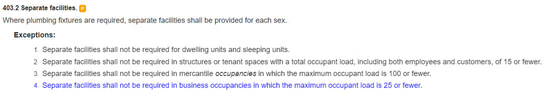

Is this from 2015 though, this looks like it might be 2021 based on the later exceptions?
I think 2018 was the first to introduce number 4 which you circled.
Could just be the AHJ's I've other work in have been using more recent code so this hasn't been an issue. The Reviewer appears correct in their reading.

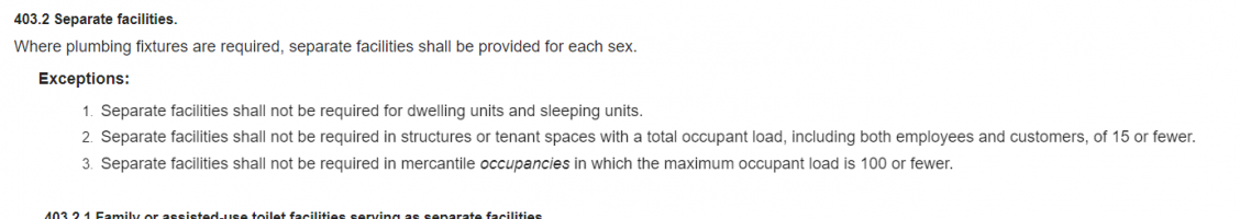

This is from the 2015 IPC 403.2
the exceptions are different. I'm puzzled why 2015 is being used here in 2023. By these exceptions it suggests you do need gender segregated rest rooms at 17 total occupancy. That must be the detail the reviewer is going with. In both 2015 and 2018 IPC the threshold is 15. But in 2021 it was increased to 25 for business occupancies.
2015
