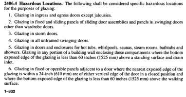

Glenn, or anyone else, some one with a copy of the 94 UBC, I am curious as to what the safety glazing requirements were relative to being adjacent to a bathtub/water.

I did find a web link for a web link to the 1994 UBC :
https://digitalassets.lib.berkeley.edu/ubc/UBC_1994_v1.pdf
