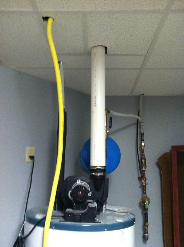

2 water heaters, 1 house, 2 vents
13,313
What is the difference between these 2?
Does the first vent go farther? Most manufacturers will allow one size up to a certain distance, but beyond that you have to jump up to a larger pipe size. Some will also allow a 3" vent even if a 2" is all that is required, but some won't. Check the install instrucitons.
