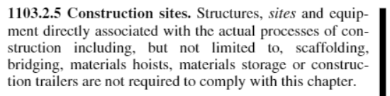

Modular, sprinklered, VB construction of 60x60 2 story and 60x204 2 story contractor teams offices. These will be set on foundations for a very large construction project. The local jurisdiction has approved "Temporary" for 10 years and by siting the code in this thread heading are not requiring accessibility, i.e., elevators/lifts to the second floor levels. The issue is, modular building plans must be approved by the State Modular Building Program first and the State CBO will not approve the plans without the elevators or lifts on the plans, even if they were to be exterior of the building or site installed. His thought is, the local jurisdiction is misinterpreting this code. I'd like some input from other building officials as to how you interpret it and if you agree with the local BO in this case what code or definition would you defend your interpretation with?
1103.2.5 Construction sites. Structures, sites and equipment
directly associated with the actual processes of construction
including, but not limited to, scaffolding,
bridging, materials hoists, materials storage or construction
trailers are not required to comply with this chapter.
I don't have commentary for this, but "construction trailers" might not be intended to mean "office trailers"....Not sure if you would get out of it if you only had offices on the second floor and common functions on the first?

Don't think I agree with the local BO. I read construction trailers as just that. Spaces used by construction personnel. A sales team, show-room, clerical personnel space etc. means an office to me and would not be exempt from the requirements. We care currently working on one for our own city building, and it is an office used by the personnel being displaced by the demo and reconstruction of their building. The contractor has their own construction trailer, and it is just for the construction workers. And 10 years as "temporary"?
Other parts of the means of egress code, 1009.3 and exception 2 & 5 also lead me to question why we wouldn't be able to use the interior stairway(s) as the accessible means of egress rather than an elevator.
Yes you can use a stairway for an accessible means of egress but you also need an accessible route to get to the 2nd floor because it is more than 3,000 sq. ft.
