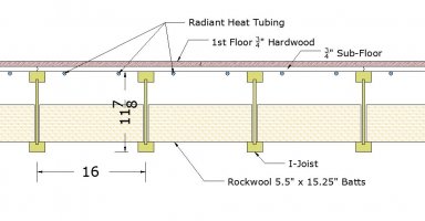

Unfinished basement, 2015 PA IRC, R302.13 allowable methods for compliance to meet the requirement.
Radiant Heat under the flooring, Installing Rockwool Safe & Sound Fire and Sound Proofing Insulation as detailed below.
Do you consider it to be in compliance? Below the sketch, I posted a link to a training video from the APA that was done on I-Joist and meeting 302.13 of the 2015. Based on what I am seeing in that presentation, the sketch complies IMO. What say you all?
Please keep it civil, looking for yes or no's and why. Thanks - Tom

Is your concern the 4” air gap on top of the insulation?
No, the 4.5" air gap is fine, might add more insulation when doing the install, but what I am confirming is that the APA documentation linked above shows the Rockwool Safe & Sound product of 3" or more in the drawn configuration as meeting the 2x10 min equal, as Steveray noted.
I am wanting to confirm that others agree with this and don't require the bottom wood flange to be covered with sheetrock.
How deep are the joists? I would probably go with the Energy code R30 in the floor and then use the gyp panels on top of the flanges....Gives more of a finished look and people get creeped out by exposed insulation and then install a second vapor barrier or a first one on the wrong side...
Steveray, The basement is 10ft rough height and will eventually be finished with a drop ceiling set at 8ft, if the insulation was basic fiberglass I might think about it, but the Rockwool is a whole different product.
I think the equivalent of a TGI 11 7/8 is more in line with a 2 x 12 = 11 1/4 , 2x 10 9 1/4
I know that! just pointing out the differences in depth, same for LVL's & paralams. The residential code as you know is for the average joe or jane to build a house prescriptively with dimensional lumber...
