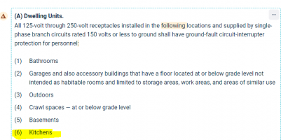

Per the 2020 NEC, receptacles for electric ranges are required to be GFCI protected if the receptacle is located within 6' of the sink.
We are having issues with the double pole GFCI breakers (Square D Homeline) nuisance tripping on these ranges.
I'm sure other jurisdictions are having similar issues, how do you guys handle this in your jurisdiction?
2023 it will be all ranges....We tell them we don't care and the manufacturers got that into the code to sell product so take it up with them...Or keep the receptacle further than 6'...until that goes away and maybe the manufacturers will figure it out by then..
Expanding on the requirement for the 2020 NEC:
The requirement of 210.8(A)(6) is intended for receptacles serving the countertop. However, 210.8(A)(7) would apply to any other single-phase receptacles rated 125- through 250-volts that are located within 6 feet of a sink.
Receptacles installed below the countertop for appliances such as trash compactors are not required to be protected by GFCIs if the receptacle is more than 6 feet from the inside edge of the top of the sink bowl. A receptacle(s) installed behind a refrigerator is installed to supply that appliance, not the countertop, and is not covered by this GFCI requirement if the receptacle is more than 6 feet from the outside edge of the sink. According to 406.5(G)(1), receptacles installed in countertops and work surfaces cannot be installed in the face-up position because liquid, dirt, and other foreign material can enter the receptacle.
Sinks in kitchens are not the only sinks where a ground-fault shock hazard exists; therefore, this requirement covers all sinks in a dwelling. This GFCI requirement is not limited to receptacles serving countertop surfaces; rather, it covers all 125- through 250-volt, single-phase receptacles within 6 feet of any point along the inside edge at the top of the sink bowl. Many appliances used in these locations are ungrounded, and the presence of water and grounded surfaces contributes to a condition of increased risk of electric shock. The exhibit below illustrates receptacles installed within 6 feet of a sink located in other than a kitchen that are required to be GFCI protected.
